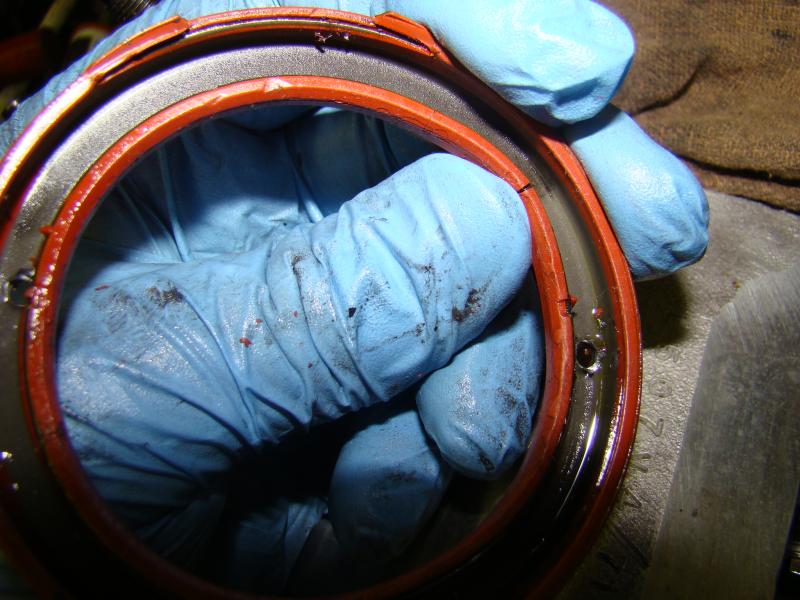

The CT has the large silver tube running through the oil pan which is essentially a tunnel for the propellor shaft to pass through taking power from the gearbox at the front to the differential at the rear. That tube is a source for oil leaks and its not fun to access, especially the pinion seal which is leaking on this one.
Pinion seal is a bit of a drag. This is probably the single most potentially devastating error that can be made that would suck beyond belief if it leaks. The engine would need to come out, gearbox off, engine off pan and tube removed just to access this one seal. So I put in the new seal, it looks good and thats all you can do. The tube will have new o-rings and gaskets before I put it back in.
There is nothing on a boxer that would suck as bad as this if it had a problem. I would pull a boxer engine 3 times before wanting to change one CT pinion seal.
